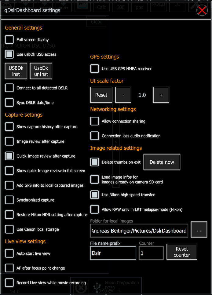

- qdslrd_settings.png (185.64 KiB) Viewed 37373 times

Will check the RAW option.
It is normal that no file is downloaded when 'Image review after capture' or 'Quick image review after capture' is disabled.
