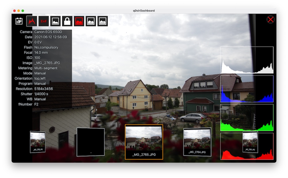

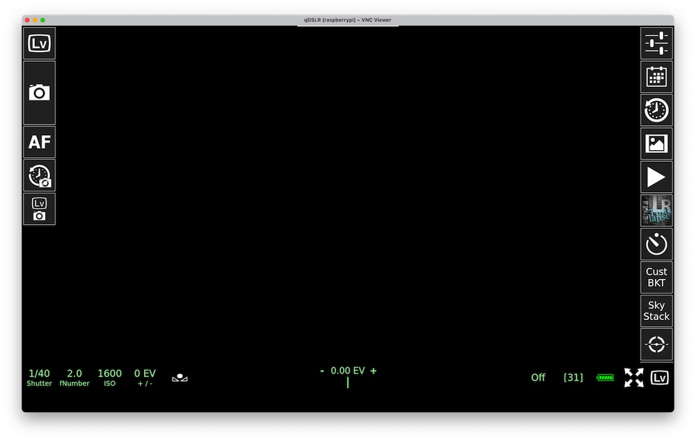

Hello qDDB Community,
On my summer holidays I wanna try to take some shots of the Milky Way and the Perseids and maybe als try to capture a holy grail time-lapse right away.
Unfortunately there is no App for iOS available any more. Therefore I tried to use a Raspberry Pi 4 with qDDB and finally I even got it to work.

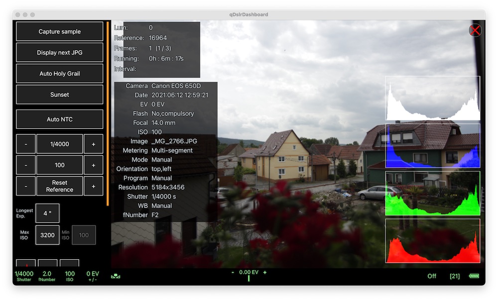

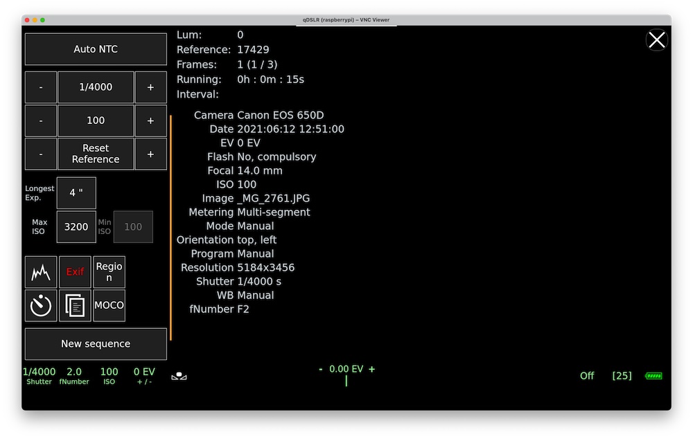

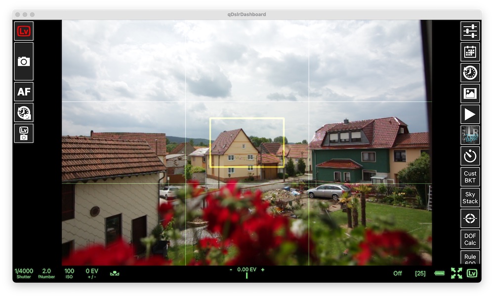

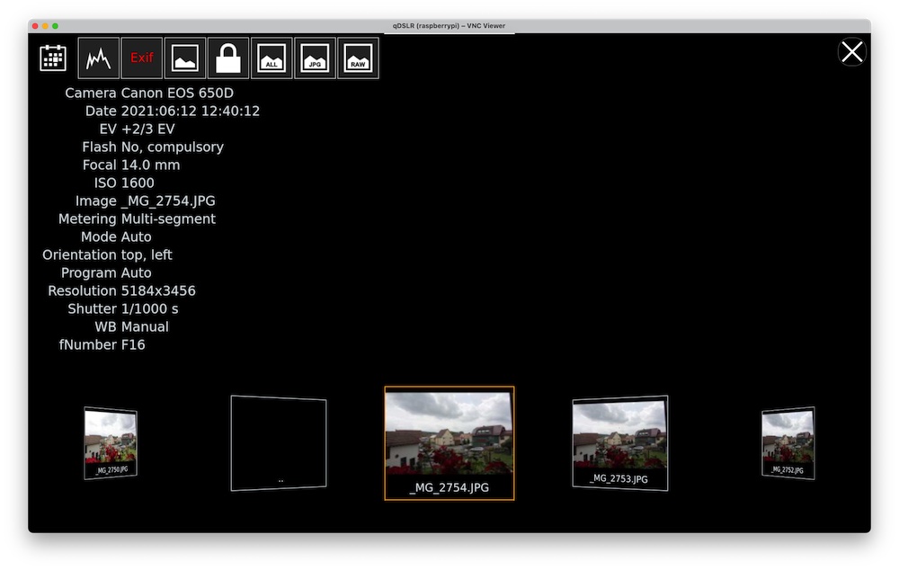

The Problem is, that I don't get a Live View picture on the Pi, the screen keeps black. Even in the gallery it shows me the thumbnails and I can see that the pictures are loaded, but they don't show up on screen. And also in LRTimelapse-Mode, when I capture an image, it is analyzed but not shown. Also the histograms can't be shown on screen. On my MacBook it works all fine, see pictures below.
Another problem I have noticed is, that the icons on the upper left don't turn red when activated.
Does anybody else have similar problems or even knows how to fix it? Many thanks in advance, I hope you can help me.
MfG DerDave

Ok, I now set up a new system on a fresh formatted SD-Card. I thought there could be a conflict with anything I installed before. Unfortunately it didn’t help at all, still the same issue.
I also made a test run with lrtimelapse and it works just fine, besides the fact that I can’t see any of the analyzed images on the screen.
