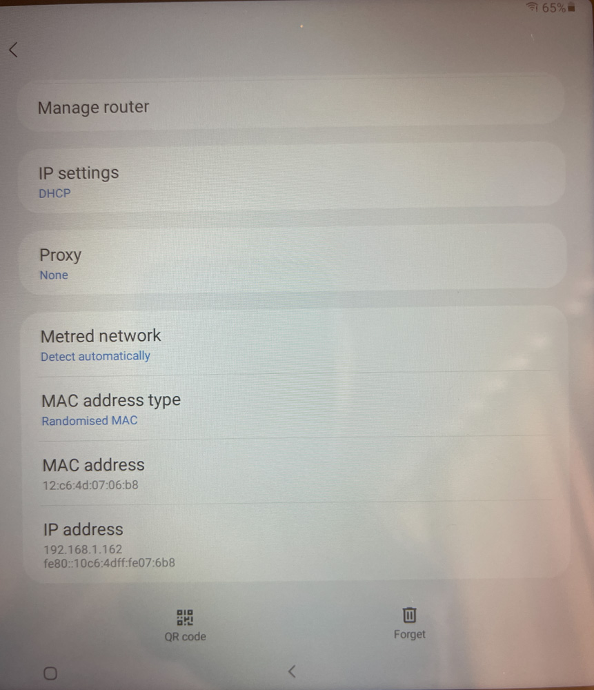

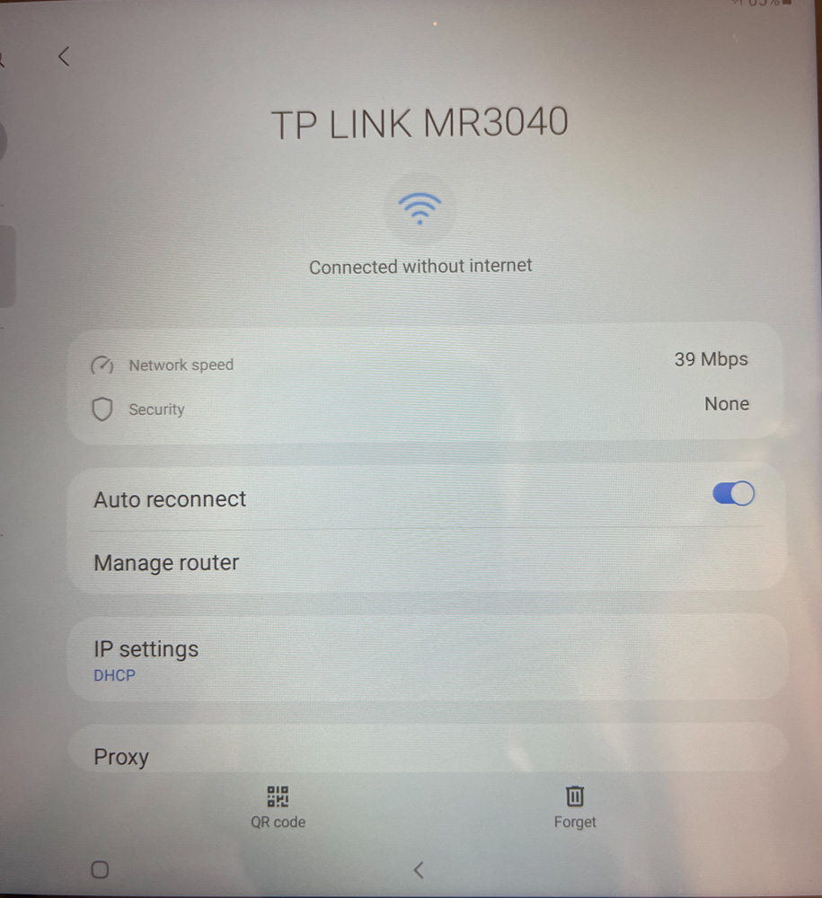

So is there something I have to select for the Route options in the Tablet ?
these are the settings, I have not changed anything.
Without the router, if I use the USB C hook up between the laptop and R5,
qDDB works perfect.
I would have thought any Android Tablet would work.

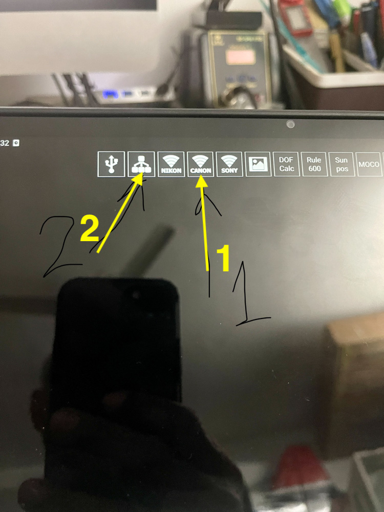

Apparently, with the iPad Mini2 and Canon 5D Mk3 I used to click the icon marked at 1
Now with Samsung Tab A8 and R5, I have to click on icon marked at 2, and this happened by accident.
But qDDB works perfect.
So I am back on track with Samsung A8 Tab, R5 and the 3040 router.
Cheers.
