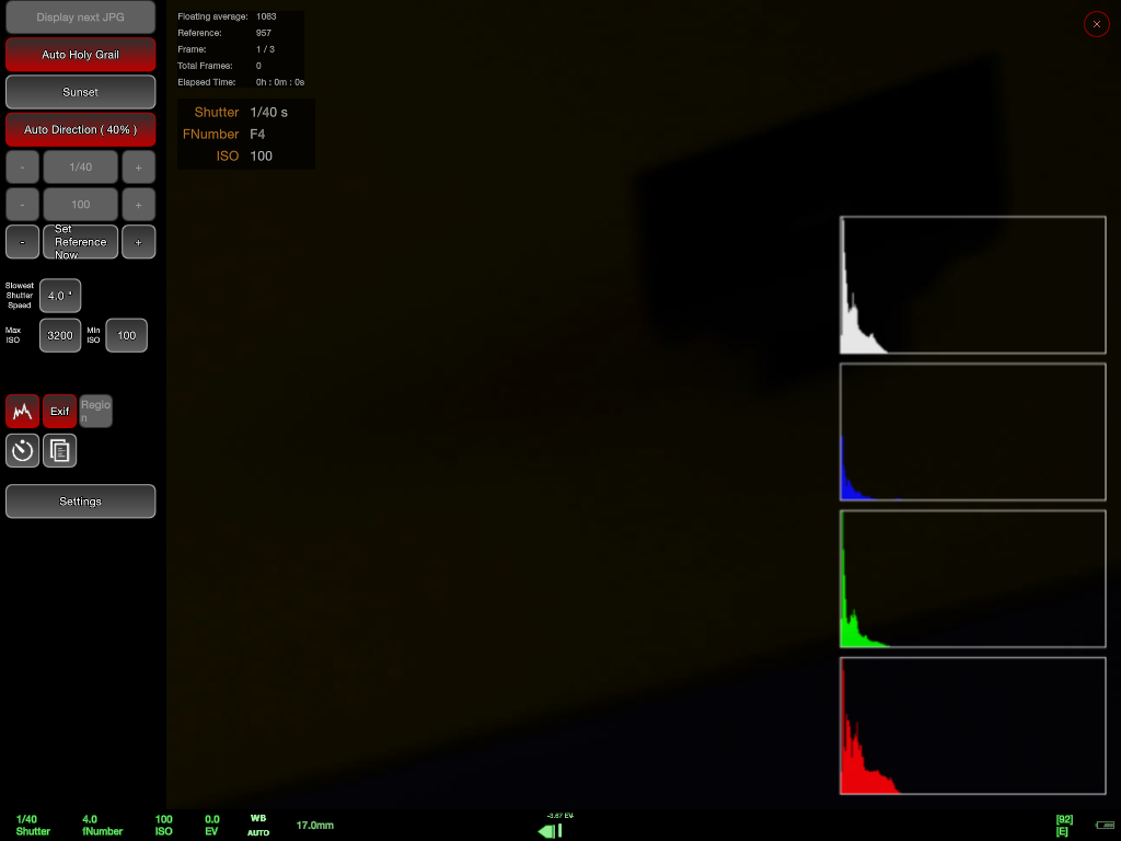

if i used holy grail, the Button "display next jpg" is gray and i can't used! If i shoot a picture With my cam the picture is not on my ipad but the floating average and reference chance the number!

When LRtimelapse mode is active, qDD downloads the JPG file from the DSLR analyzes it and then deletes it.
'Display next JPG' is disabled while 'Auto holy grail' is active as then the JPG is downloaded according the 'Frame count' settings.

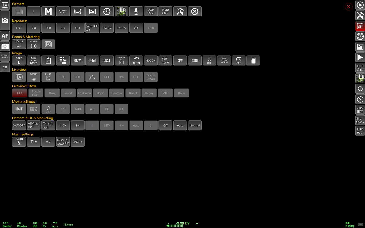

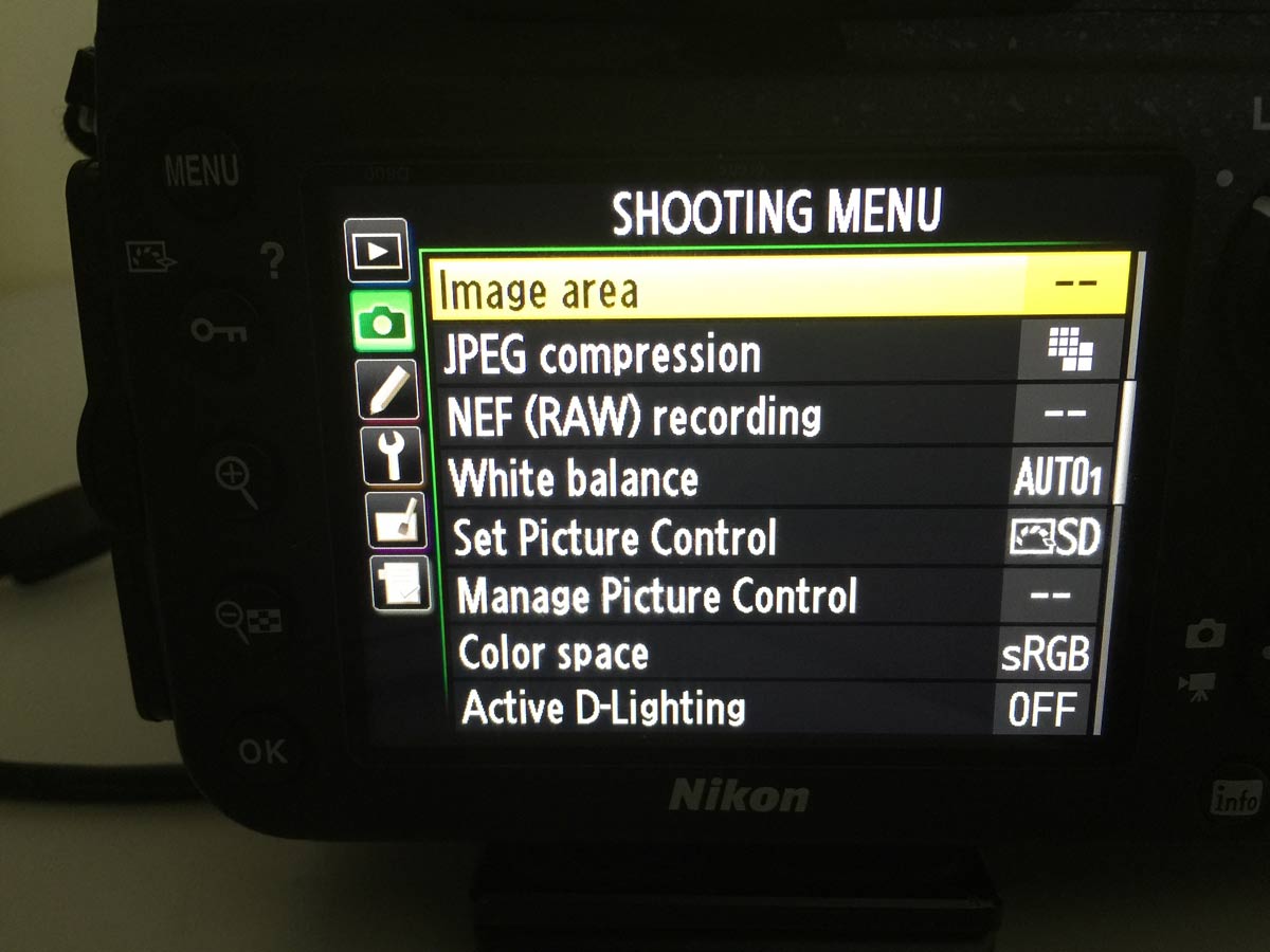

What are your D800 settings, can you make a screenshoot of the 'Camera properties display' ?

Hello!
here more information! from my settings
Manuel
Joined: 20 Jul 2015, 22:54
Re: Holy Grail Picture Transfer
Post by Manuel »
her d800 settings
I see that exposure drive mode is set to continuous capture, can you try and set it to single capture?

what means exposure drive mode? In the in the user manual from the d800 i can not find the exposure drive mode.
It is the capture mode: single, continuous high speed, continuous low speed, etc first button in the 'Camera' category.

i tested in Single Mode! its the same problem! i observed every 4 or 5 picture show me on my ipad ( in holy grail function)

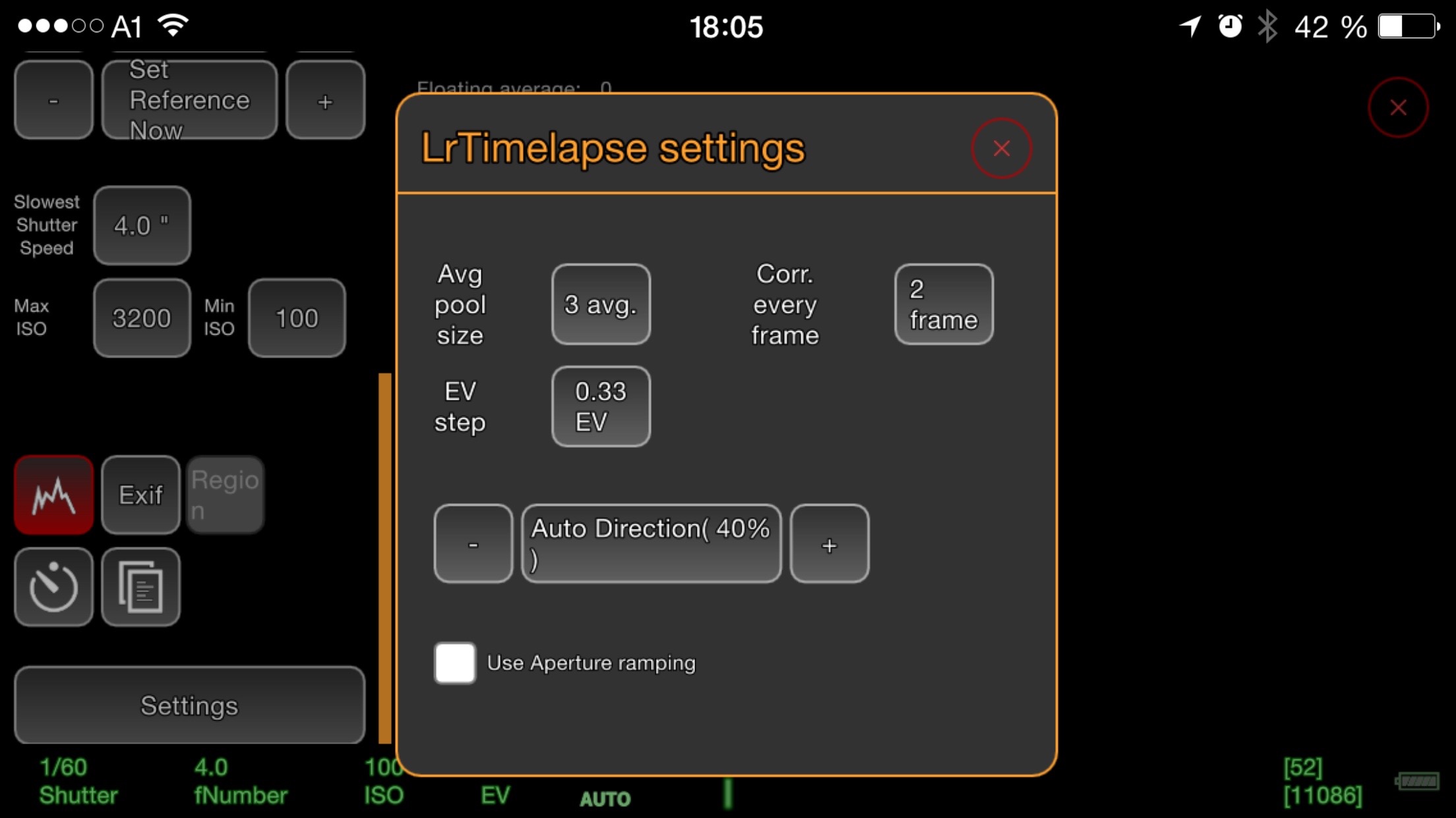

When AHG is enabled it will not display all the images. You can set the frame number in the LRTimelapse settings, minimum is 2 frames.
What interval do you use and what is the slowest shutter speed that is set?

here is a screenshot
