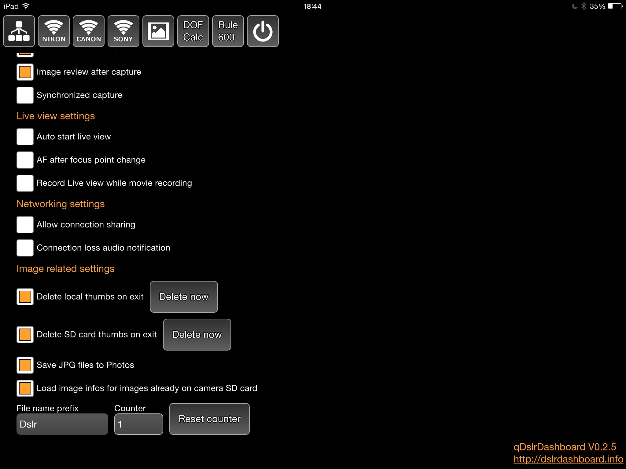

I tried the tip but it doesn't works. I can not access this IP address neither from my iPad nor from my laptop.
Your second advice also didn't work. I pressed long the Network button, then the IP address appeared, I pressed Submit, but the result was nothing as you can see in the attached photos.

Guess what! On the iPad I forgot to select the router's wireless network before anything else.
