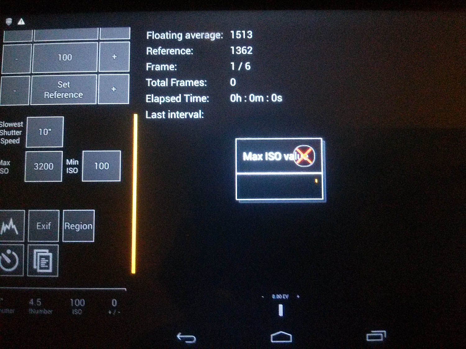

(BTW, at the version of 0.2.6, qDD's LRT menu had this max ISO/shutter speed menu info not displaying bug,but it can be easily fixed by reopening the LRT menu , so it wasnt a big deal... at that time)

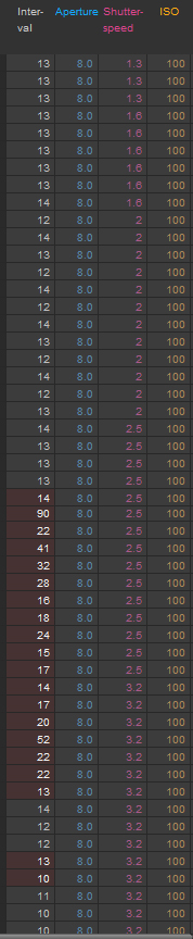

"The inconsistent intervalometer interval time and random pauses on timelapses"
i have some screenshot from my LRTimelapse workflow here to show you the problem.
I called it deadly because that long pause in between frames will simply ruin the shot. It's unexpectable, not every shots have this problem. But this bug really frustrate me and i couldnt find anything to prevent it from happening, the only thing i can do next to praying is to pay full attention to the intervals each time when i'm shooting.

0.3 continue to suffer the random pause and inconsistent interval bug, and with the new UI introduced, its now impossible to avoid the 'max iso&SS not displaying bug" by reopening LRT menu anymore, hitting exit will either terminate the connection between the app and the camera, or it will just shut down qDD completely.
