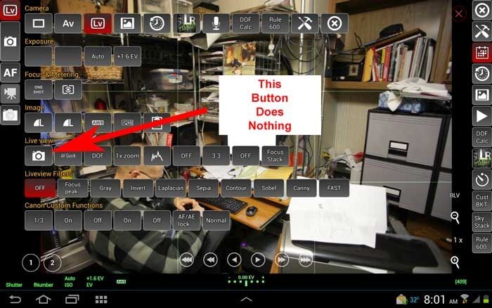

Great app, just a small glitch. I can't seem to get video to start recording. I have a Canon 5D MK II and am using a Galaxy Tab 2 10.1. I have attached a screen shot of my tablet. If I understand the instructions, in live view mode, the button I have indicated is the one that would toggle between video and still shots. I assume that pressing this button would change the icon to a movie camera icon much like the one to the left on the main screen that is NOT highlighted. And, the non highlighted button would now be highlighted and usable. Everything else works both tethered and wireless using the TP-Link MR3040. I know that the camera is capable of doing this because it works in dslrdashboard for android version 0.30.33 with a tether.
Is anyone using this combo successfully? Would possibly a different Android device solve the problem?

No it wouldn't.
Seams on 5DM2 switching to live view movie mode is done with a different command/value.
Will check the code to see if I can find out why it does not work.
