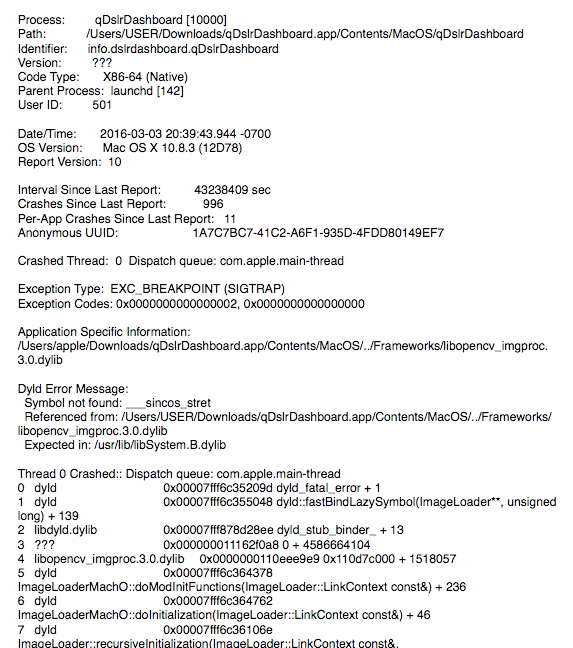

Hi, is qDslrDashboard compatible with 10.8.3?
It quits unexpectedly every time I try to open it. I don't have this sort of issue with any other apps.
Any thoughts on the cause? I'd love to try this program. Thank you!
Top of crash report attached…
Re: qDslrDashboard won't run on OSX 10.8.3
Yes it is.
Please try this test build: https://drive.google.com/file/d/0BxMZ8X ... sp=sharing

OK, that one works terrific! Thanks very much!!!
