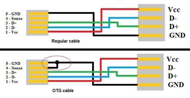

I have a problem using qdslr-dashboard with my Nikon D7100 and my ASUS memopad fhd10: when I connect these two via WLAN (Nikon WU-1a) it works perfect, all the functions are there, download of the shots works.
But when I connect the camera via USB-OTG to the pad, it even doesn´t find the camera...
When I try my wifes D90 it works via USB-OTG! (except LV, but the D90 hasn´t got LV...)
Just one word: help!! ;)

I tried all variations: switch on the D7100 first, then plug into pad. Switch on the pad first, then plug in the D7100, the switch this on... etc. nothing worked.
Could it have something to do with the connection? The D90 has a mini-USB-jack, the D7100 a special NIKON-only jack... I´m confused...
Re: D7100 and ASUS memopad Fhd10
Maybe it is up to the USB OTG adapter.
I also have a D7100 and it works for sure with USB and Android (Nexus7, Samsung Galaxy S2)
Do you use the USB cable that came with the camera?

It is the original cable from Nikon.
I use it with my laptop and it works fine, only the combination D7100/Asus memopad fhd10 does not, what it should... maybe it´s up to the Asus...
If the D90 works with USB on Asus then the D7100 should also work.
If you can try a different USB OTG adapter.

I did check the cable, all connections are as meant to be...
So even another OTG-cable would bring the same results.
Maybe it would help, if I root the pad? I dunno what to do... or I´ll leave the D7100 at home and take the D90 with me to our holiday on La Palma... ;)
I had a USB OTG that was working on one Android device but it didn't work on another.

You won´t believe it: it works!
And why? It´s the Nikon-USB-cable, it has a slack joint! Used it in the studio for product shots and the jack at the camera-side must have been bent...
So far, so good!
