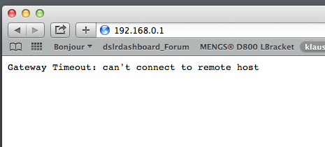

But typing in 192.168.0.1 gets me "Gateway Timeout: can't connect to remote host"

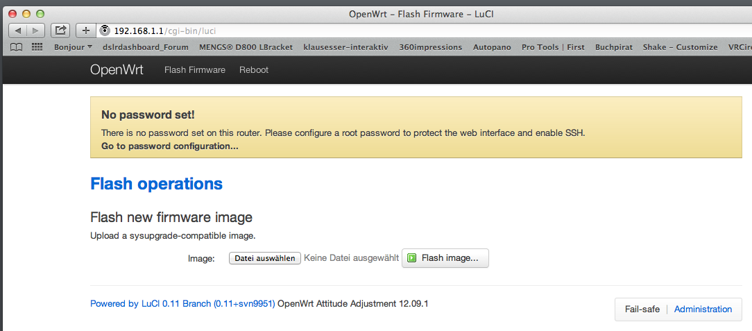

Typing in 192.168.1.1 works fine - but doesn´t run the flash.

Re: flashing a TP-Link WR 3040
Connect the MR3040 to the MAC with network cable.
Open your web browser and navigate to http://192.168.1.1 and finally make a screen shoot of the web page that you get.
Also repeat this for the http://192.168.0.1

2 screenshots:
You already have OpenWrt on the MR3040
Click the 'Go to password configuration' and set a password that you will not forget
You can access the administration page by clicking the 'Administration' button in the lower right corner
After you set the password using the Administration page navigate to Systen->Software and check that you have the 'ddserver' package
Post by klausesser »
Hi Zoltan!
Thank you for clearing the issue!
The problem was: there already WAS a firmware-update on the device. So it refused my attempt to update
via 192.168.0.1 - i just needed to use the 192.168.1.1 procedure only for installing the server.
The descriptions nevertheless mentioned to use 192.168.0.1 as the first step on a brandnew device . . .
That was what confused me completely: 192.168.0.1 wasn´t needed at all. 192.168.1.1 did what was needed . . ;)
