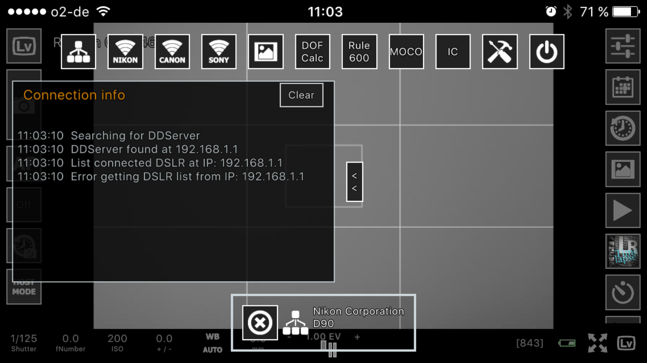

Hi Hubaiz, it works!!!!!!!!!!
I do not know why, but I resetted everything upgrading to the latest firmware, got access to the router still saying: "DDServer not found" but 1 DSLR found. Now it tells me "DDServer found" and I can go on trying the timelapse-feature.
Thanks and kind regards, Chris
- IMG_8297.png (209.84 KiB) Viewed 10938 times

yes, now after all thiese efforts I can start taking timelapses! I am happy, we can handle it, it seemes that the problem was caused mainly by the cable.
All the best and have a good time!
Chris
