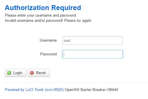

When I found out about the TL-MR3040 hack I found links to DSLR COntroller and did not notice that it also required a different "factory" file. So I upgraded mine with the file I found here: http://www.dslrfilmnoob.com/2013/12/11/ ... ontroller/
Is there a way to get it back to original software - I mean a way that a non-programmer can use? :)
Opening 192.168.1.1 now shows this (I have no idea what the password might be):
Re: Accidentally installed a wrong "factory" file
The OpenWrt firmware with the ddserver package for the MR3040 can be downloaded here: https://dslrdashboard.info/downloads/
You need the 'sysupgrade' image and follow the instructions here: https://dslrdashboard.info/tp-link-mr30 ... e-upgrade/
As far I know the default password for the DslrController image is : dslrcontroller
