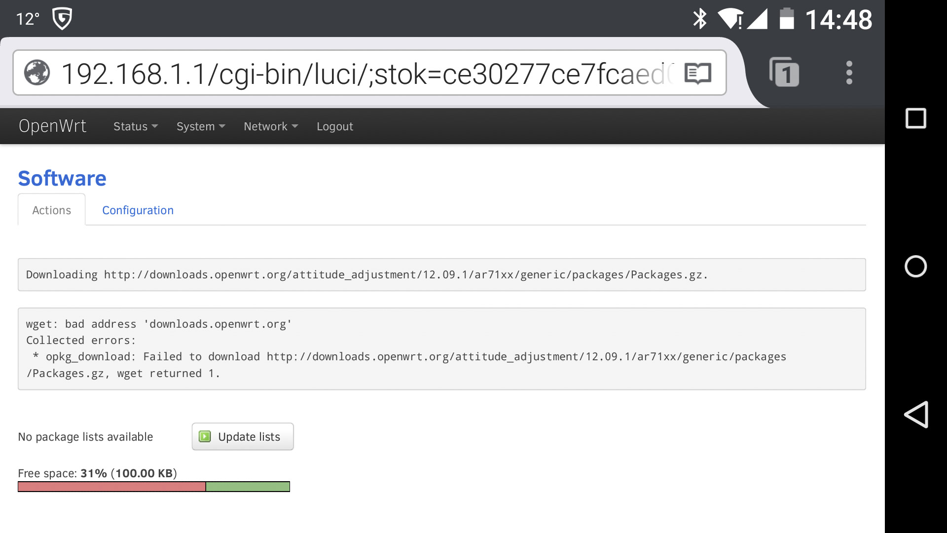

I had already tried the Administration-Button, but it didn´t work.
Find out, that I have to zoom in on my advice, so the button is much bigger, than it works
So this is what I found:
- unbenannt (1 von 1)-9.jpg (178.36 KiB) Viewed 12234 times

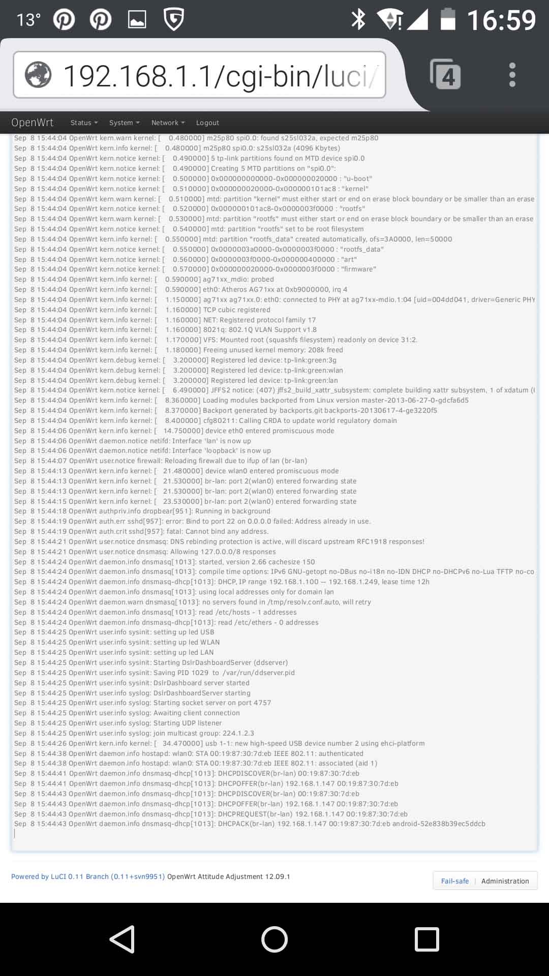

Sorry! Do you wait for this? This is what appears when I type system log.
Thanks for your patience!
- unbenannt (1 von 1)-10.jpg (174.05 KiB) Viewed 12217 times

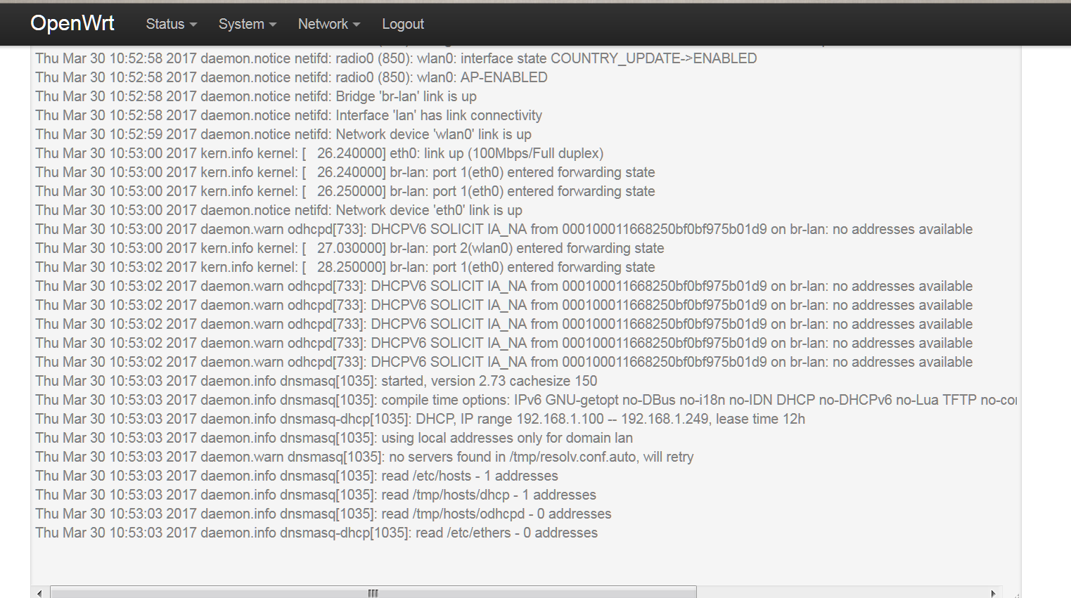

I hope, that I have done it in the right way, (as it is discribe in the link)
this ist what the System Log looks like now. Is this something you can work with?
- nach sysupgrade.PNG (162.9 KiB) Viewed 12206 times
